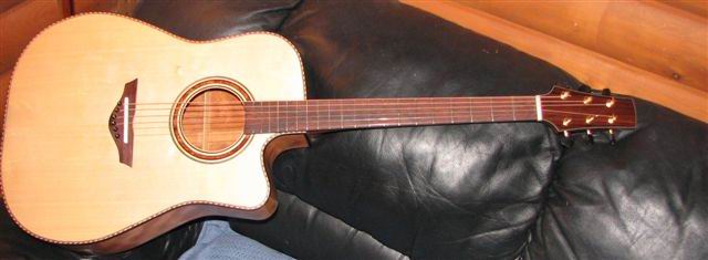

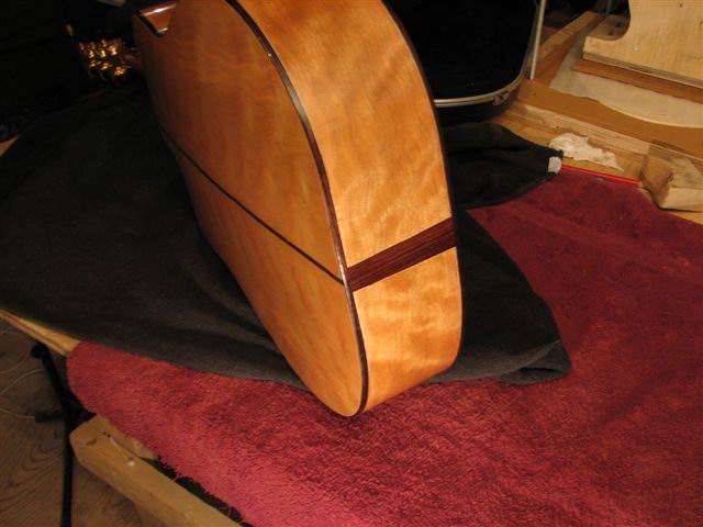

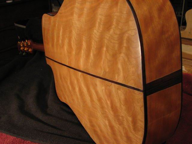

   It's been a long time coming. My first is finally done. Particulars:
-Curly Cherrywood from Steve at Colonial
-MadRose bridge and finger board
-trim in EIR (headstock, end graft, FB and body trim)
-Koa Rosette
-Gold Schallers with ebony buttons
-black horn bridge pins
-FP finish
   I build her from scratch and she was done on a hot pipe and free formed. I'm never doing that again!
   I hope you enjoy the pics.

   I'm going to be using molds from now on. I'll still bend on the pipe and build from scratch, though.
   One of the many mistakes I made during this build was that I glued the sides to the top and then I left it there for about a month or two without the back, this in the hottest and most humid time in the summer.... Combine this with the fact that I had cupping akin to the surface of a golf ball (too much water bending light colored curly woods) and I had a real hard time gluing the back on there. I had to use screws (where the binding would eventually be and the end graft) in a few spots and actually pull the sides open using traction with some wire... Stupid me!
   So from now on it's a female mold for me. That and trying to close the box with a few days...

Very nice job Alain, Love that curley cherry.What kind of top is it? Looks Great !

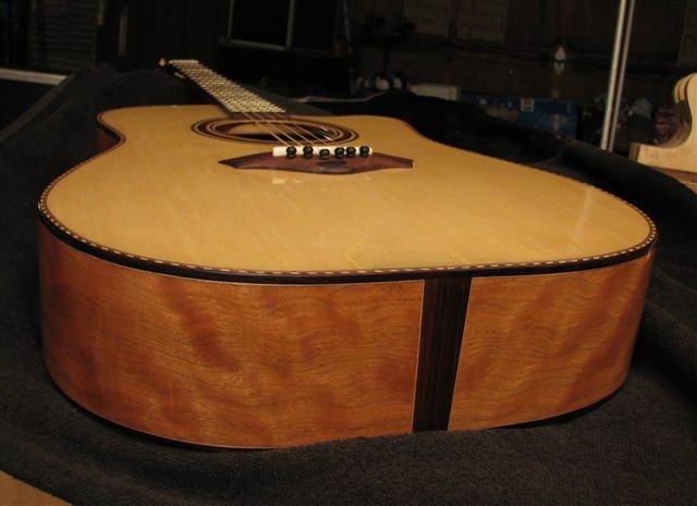

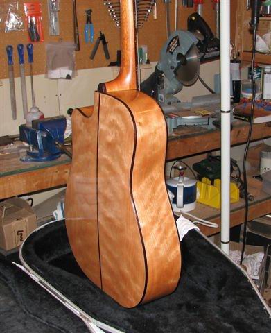

Sure guys, a pic from the front and the side...

Dave, the top is bearclaw sitka spruce from Alaska Specialty Woods... There is one little pitch pocket but... I can live with it...

Looks great, Alain! Don`t you just love that cherry?
